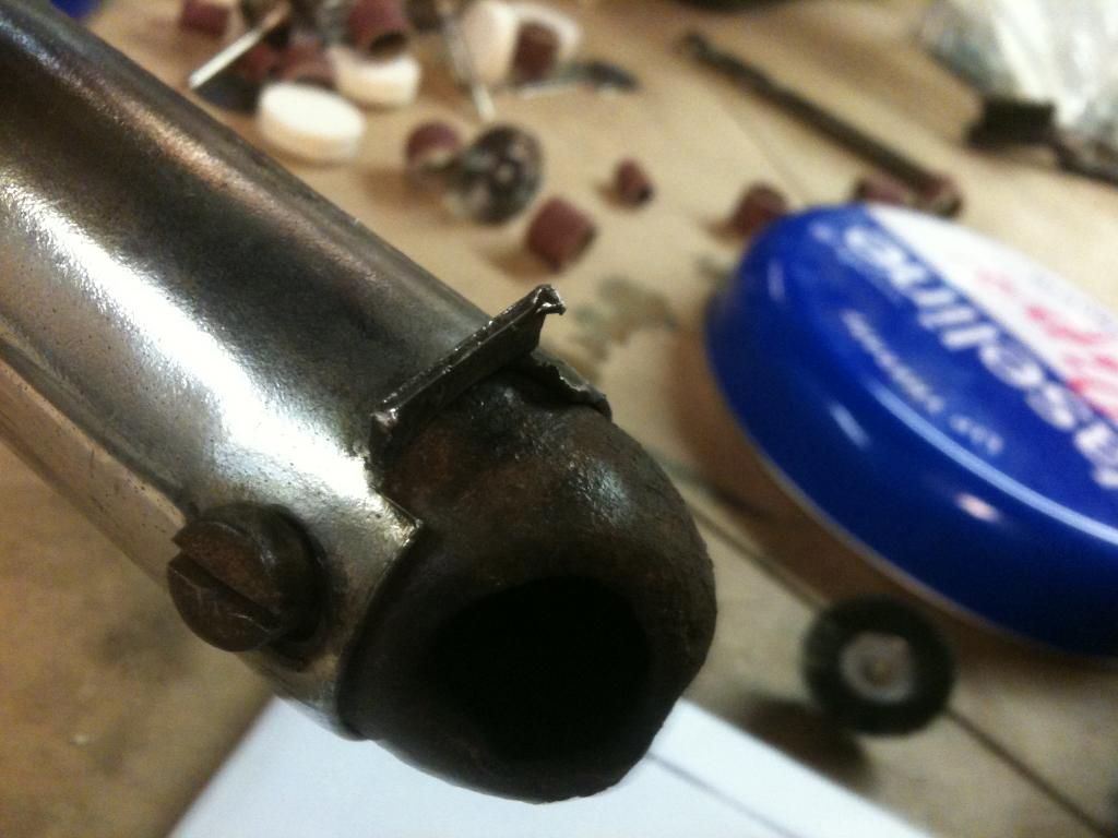

Guys does anybody know how to tell if the high exhaust is original? i can not see any identifying markings or numbers?
The hole in the baffle looking from the rear is at 4 o clock & the fixing screw about 3-4 o clock as well,it has this little cut out on the underside
